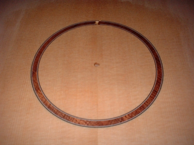

Thanks for the advice guys it helped a lot.
Went quicker and smoother than I expected and I'm pleased with the result.
(I apologise for the bad picture quality believe me it looks OK !)
Cachalote39069.5309953704
Richard
PostPosted: Mon Dec 18, 2006 5:01 am
Looks fine to me, that's another process ticked off on the skills list!
